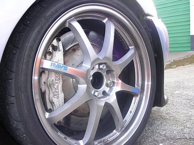

Look at the bottom picture on my post, that is the floating fronts. They don't use the conventional floating way like I have on my Cossy's i.e. with bobbins, but they use those little strips that expand and contract with the heat. Full floating, no wobbling or vibrating at all.
Another option is Hi-spec that I sell. Audi RS4 kit 360mm 6 pots from £1600 with some braided lines and proper brake fluid SRF, RBF etc will be awesome too.

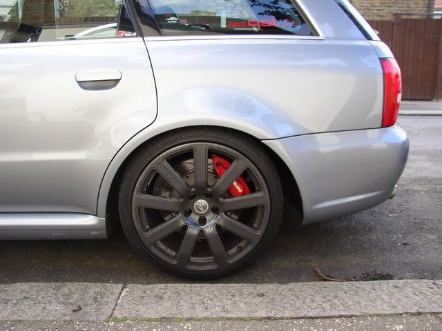

This is an interesting thread. Andiroo, are you saying that AP six pots and the like have more pad surface area than the 8 pot Brembos? I was under the impression that there was a significant pad surface area on the Bembo's, being that there are two pretty large pads clamped to each side of the disc, which is twice as much as the OEM B5 items. Since upgrading to the B7 setup, I've not had any problems, and than includes several track days and braking hard from 165+ over ten times last Sunday.
After 3 laps of Bedford on the standard setup the brakes were shagged, so, from my experience, I'd have to contradict what you say that the Brembo's are not an upgrade and are poo.
